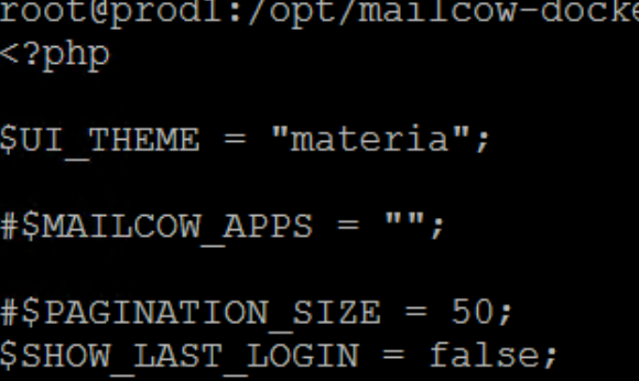

        kingfisher I only have the following content in the file. I don’t know if the same is affecting the issue.
        I think I might have changed the theme from Lumens to materia when initially setup mailcow.

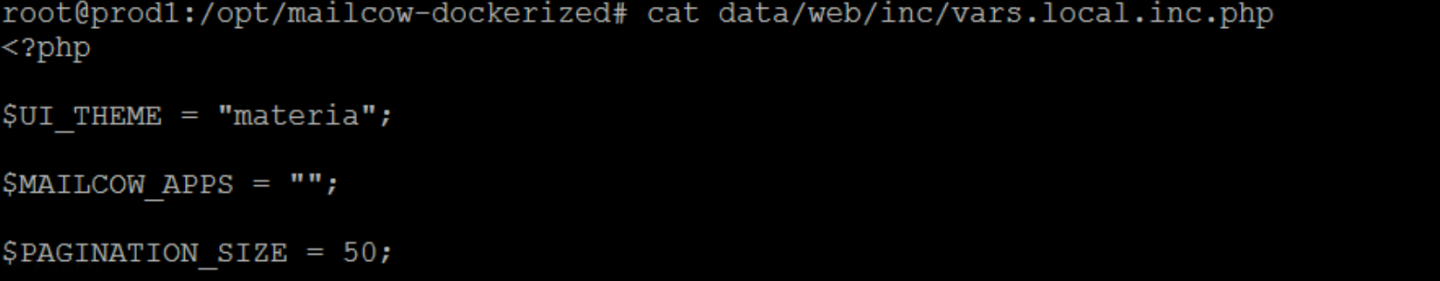

        I removed the vars.local.inc.php file and updated the mailcow with stable release and it updated fine without the blank page issue and the same is now showing as shown in following:
        I was still not convinced that the vars.local.inc.php file would be causing the issue, so I copied it back as shown below:
        And the same mailcow UI came fine. Everything is working fine now without the blank page.
          mailcow-helper Did you restart Mailcow to check if it still works afterwards? It may be possible that the file isn’t loaded if it wasn’t there during the start of the php container
            DocFraggle … Yes of course. I did whole down and up 3 times to better check if it’s working or not. Well, I experimented with Mailcow UI Theme from Lumen to materia (I like Google Material Design a lot) and the difference is here:
            Default UI:
            Materia UI:
            so the theme change confirms that var.local.inc.php override is working perfectly fine.
