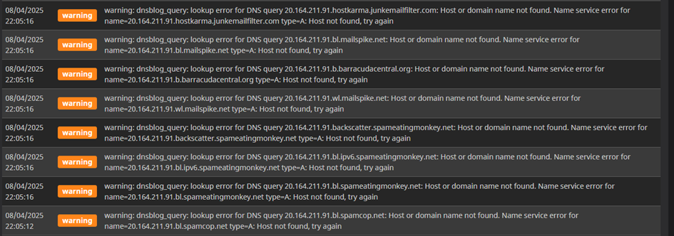

I noticed that I’m not receiving certain emails, and after investigating a bit, I realized that the issue is happening at the Postfix level.
08/04/2025 22:05:43 info NOQUEUE: reject: RCPT from unknown[91.211.164.20]: 450 4.1.8 <noreply@ldlc.com>: Sender address rejected: Domain not found; from=<noreply@ldlc.com> to=<exemple@exemple.com> proto=ESMTP helo=<mail.groupe-ldlc.com>

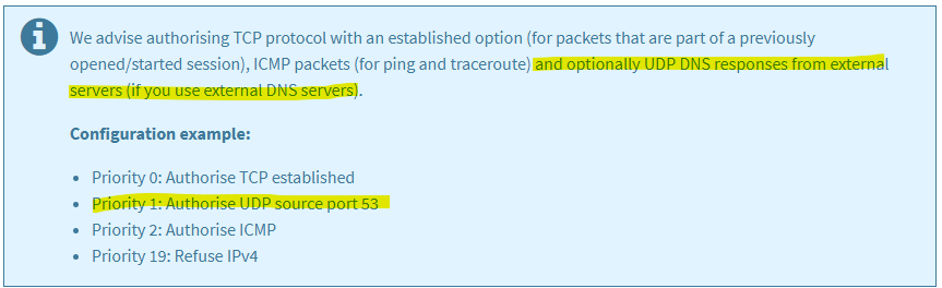

      That’s strange… do you have any kind of external firewall or a separate firewall running on the host system which may block packets? selinux maybe?
        DocFraggle
        Thank you for your response. Indeed, the issue was coming from the “Edge Network Firewall” of my hosting provider, OVH. I hadn’t really checked that point because most DNS resolutions were working fine or, in some cases, only partially. I also adjusted some long response times on my SMTP along the way.
