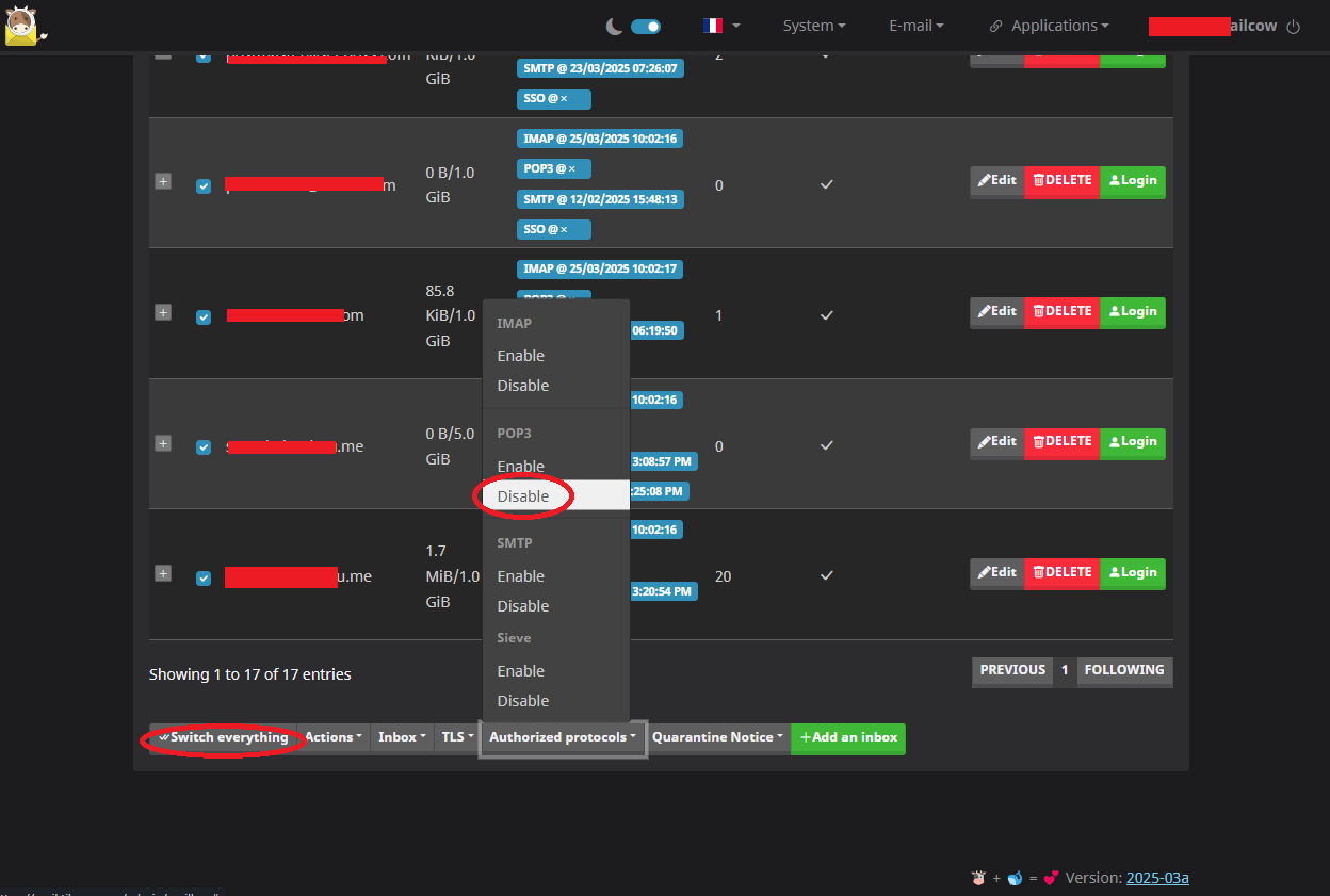

We would like to bulk change all existing mailboxes such that POP3 is disabled (I’m aware that I could change this by mailbox but we already have 250+…). What would be the recommended approach?

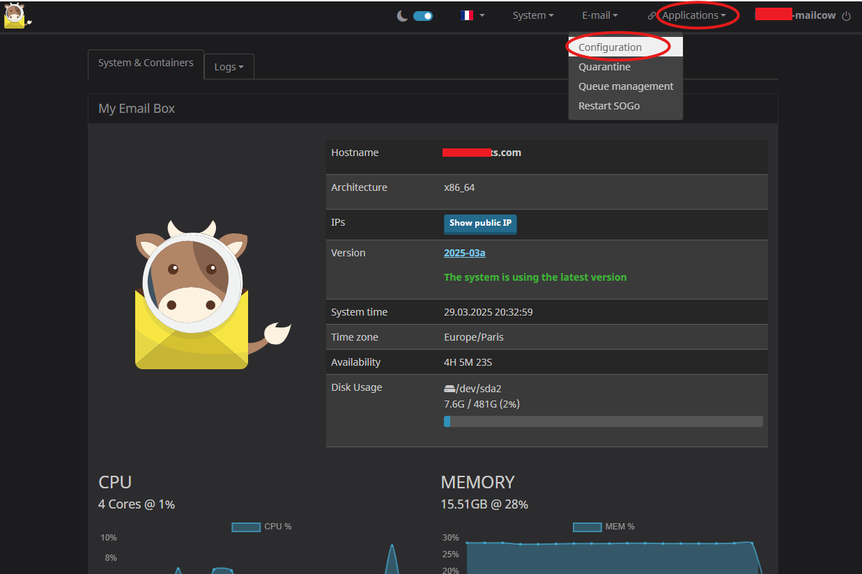

    Hi
    Just go to the Email menu then configuration, select all the mailboxes, then click on authorized protocol and deactivate pop3.

      Txs a ton!
