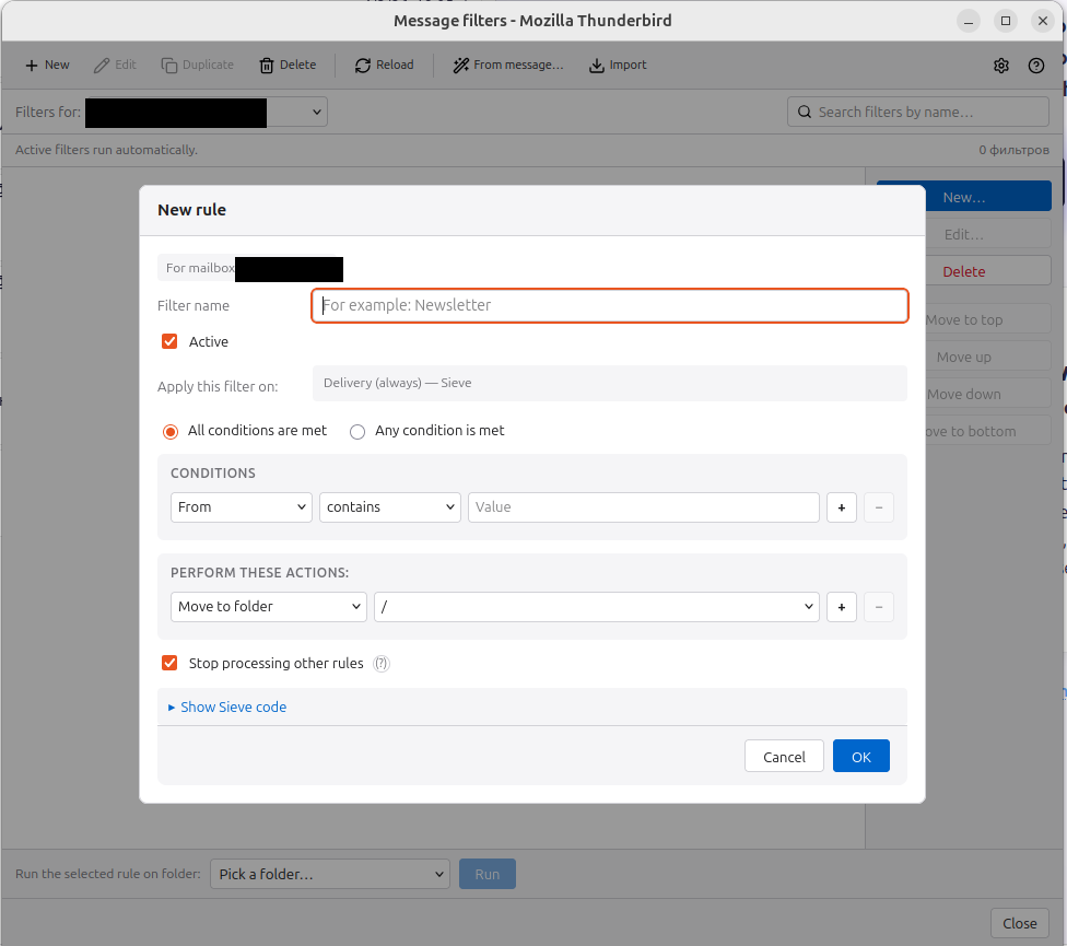

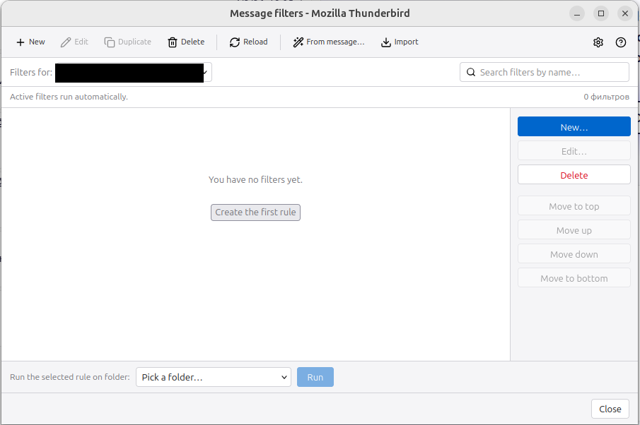

What it is. Two GPL-3.0 components:
Thunderbird WebExtension (Manifest V3, TB 128+) — UI inspired by
Quick Filters: rule manager, wizard-from-selected-message, run-on-folder,
multi-account, multi-select, import of existing local TB filters,
English + Russian locales.
expor-sieve-proxy — a small FastAPI middleware that sits next to
mailcow. Each user authenticates with their own mailcow password
(Dovecot SASL bind). The admin API key never leaves the server.
Failed auth federates into mailcow’s Fail2Ban via Redis publish.
