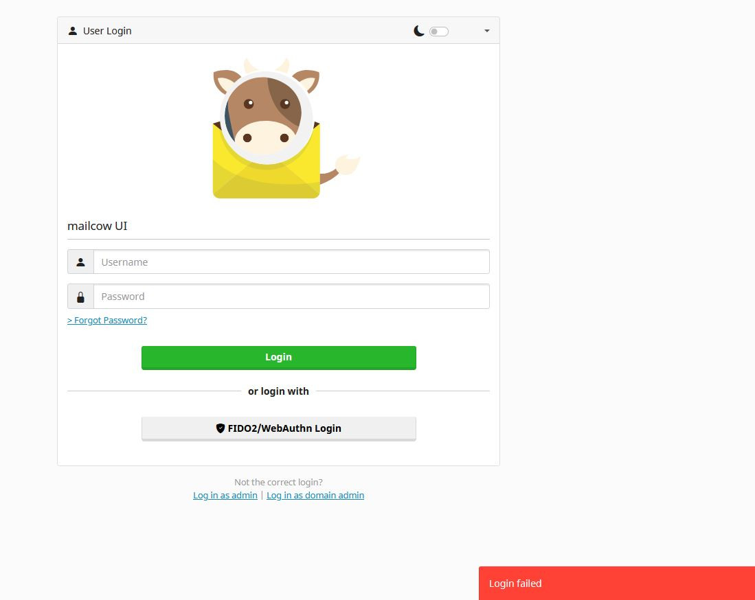

First time using mailcow, new. on AWS EC2 instant with 8 gb RAM, 2 cpu and 30 GB SSD storage. everything ok . installed docker, useed latest mailcow setup .But at the end inital login admin , moohoo password not working.i reset password still not. used AI gemini tool to further analysis still not success

I don’t trust AI gemini 100%. but my strange thing then, i did another fresh install on my office computer using virtual machine there also i got same login failed for admin account. i suspect admin account is created in marai DB, but something php module and ngx module inter communication for password hashing verification ,something not executing, or source code is currupted always for mailcow. Please help me to solve this issue. Thank you in advance.
