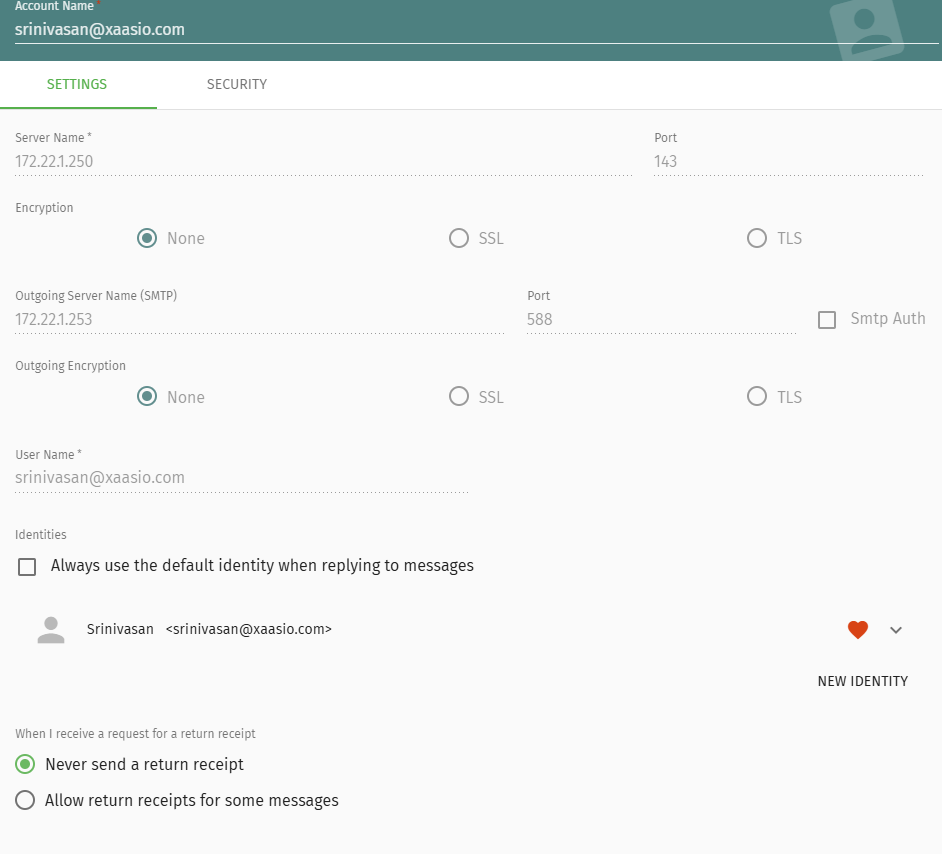

I need to configure SMTP for an email address in Mailcow to work with SuiteCRM. However, my concern is that SuiteCRM is not running inside a container; it is installed directly on a Linux system. Could you please suggest the best approach for setting up the SMTP configuration in this scenario?
esackbauer
In the screenshot provided below i have the private IPs in the Server Name and Outgoing Server Name (SMTP) fields. For SMTP configuration in SuiteCRM do i need to use these private IPs or the domain name of the mail server.

I cannot tell, you should know how your network and your name resolution works internally. You need to use the IP address of mailcows host. Not the internal docker network addresses.
Are you sure you know how docker works?
