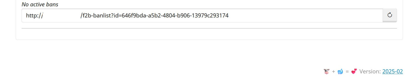

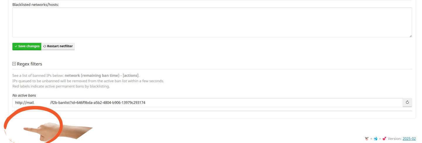

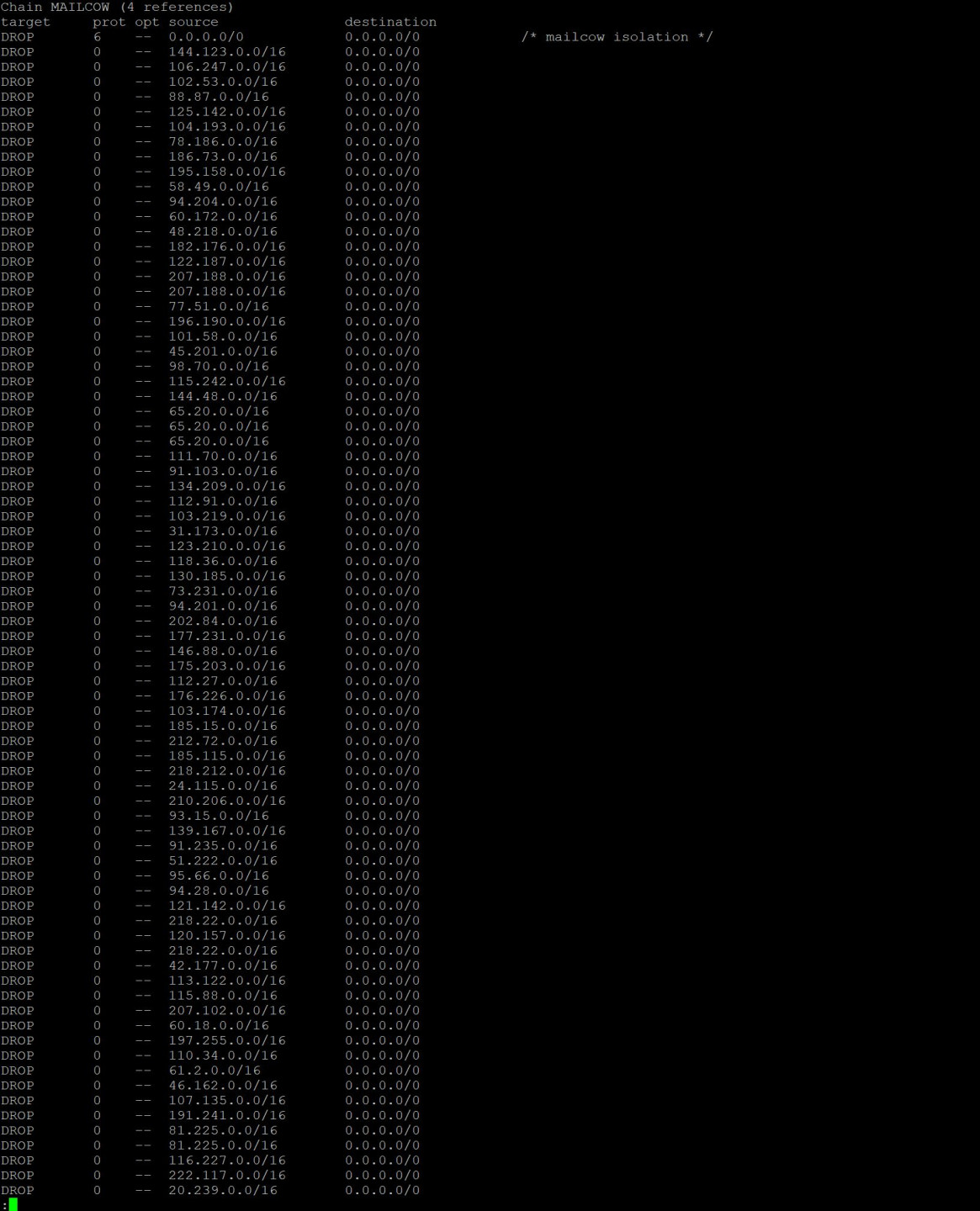

I have about 23,000 IPs added to iptables, but they are not displayed on the web interface in blue as they used to be. I don’t even know if they are being blocked at all, or if there are so many IPs that they are no longer being blocked? Do I need to install nftables or something else to display the blocked IPs? Is there any way to make fail2ban in jail.local send an email about the blocked IP, including whois information? My external fail2ban works perfectly, blocking and sending emails with whois info. If I modify netfilter or anything else within Docker using sh or bash, will it affect the proper functioning of
