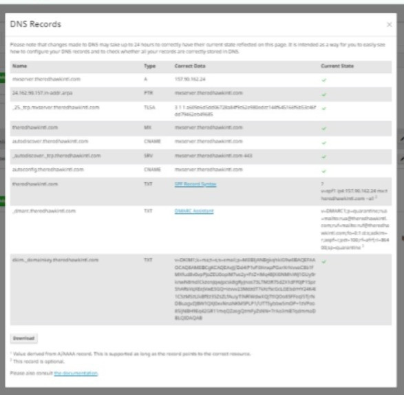

          Ok, that one looks ok to me… so please post the error message from Google without redacted content to check it further

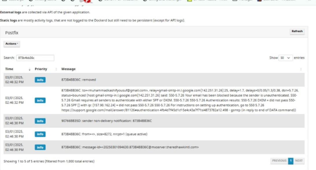

              DocFraggle the error is not from google. Mailcow server postfix log shows the below error
              873B4BB36C: to=muhammadkashifyousuf@gmail.com, relay=gmail-smtp-in.l.google.com[142.251.31.26]:25, delay=1.7, delays=0/0.05/1.3/0.38, dsn=5.7.26, status=bounced (host gmail-smtp-in.l.google.com[142.251.31.26] said: 550-5.7.26 Your email has been blocked because the sender is unauthenticated. 550-5.7.26 Gmail requires all senders to authenticate with either SPF or DKIM. 550-5.7.26 550-5.7.26 Authentication results: 550-5.7.26 DKIM = did not pass 550-5.7.26 SPF [] with ip: [157.90.162.24] = did not pass 550-5.7.26 550-5.7.26 For instructions on setting up authentication, go to 550 5.7.26 Email sender guidelines - Google Workspace Admin Help
              4fb4d7f45d1cf-5e4c43a7f71si4873782a12.498 - gsmtp (in reply to end of DATA command))

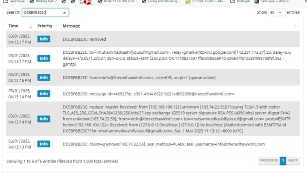

                  Make a search for 873B4BB36C, it’s ID of message and preferably post here all your findings, this log does not contain from= because it’s response from gmail, we need log about you sending to gmail.

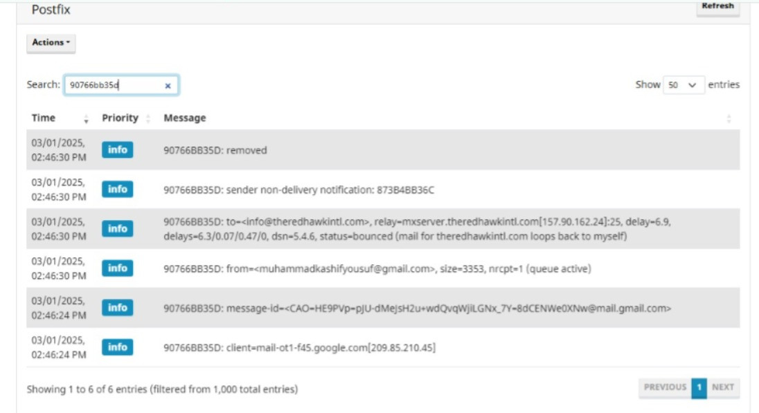

                      There is another ID 907…. referencing your message look for this one too

                        The log of ID 90766bb35d and the log of email sending.

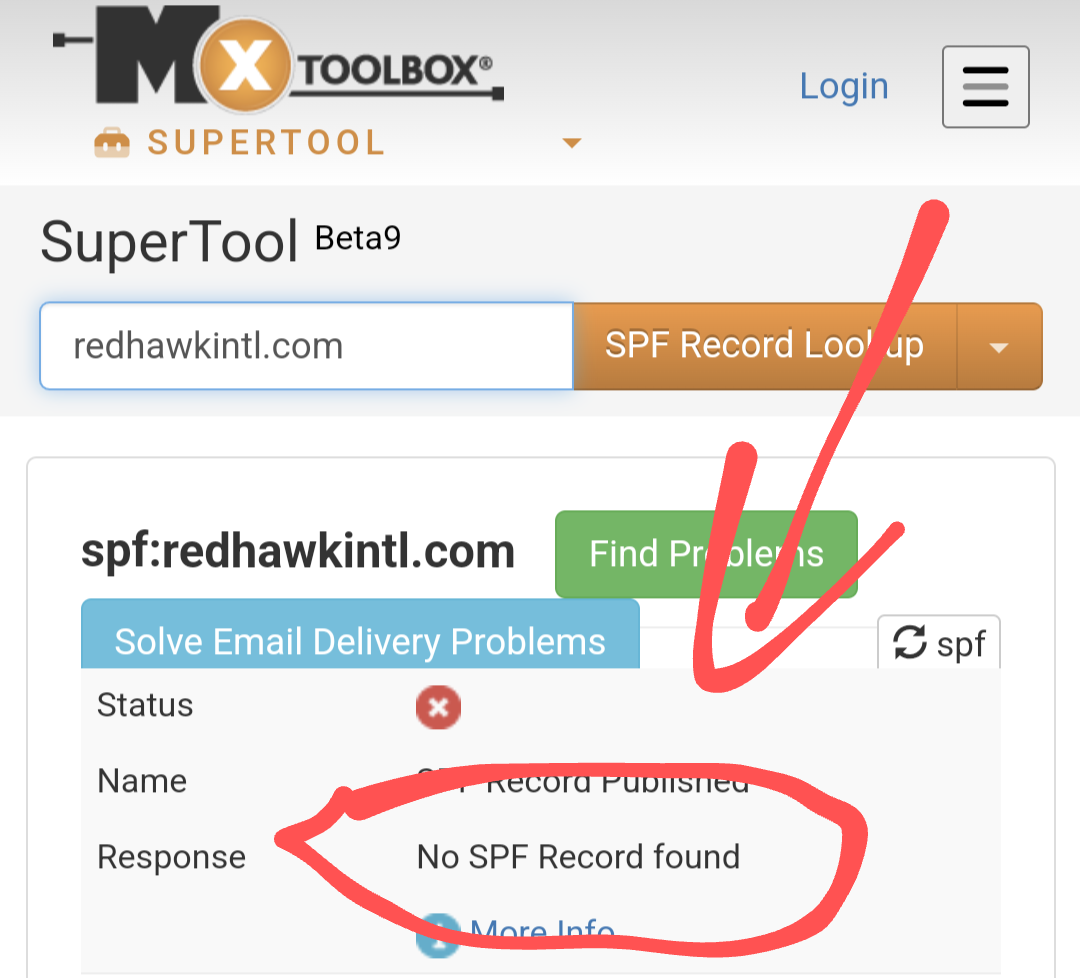

                          Sorry man, other than google for some reason does not see your SPF record. I do not have explanation. Any chance you just change your DNS settings and you need to wait a while to wait on prune of DNS cache on Google side? (up to 24 hours)
